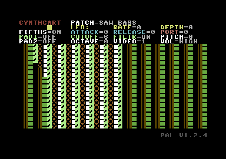

Paul Slocum has been hard at work creating more tools for musicians to generate music with old-school hardware, and his latest creation is the Cynthcart for the Commodore 64. The Commodore 64's SID chip can produce some amazing audio (especially considering its age!) and Paul uses it in much of his music (if you're not aware, Paul makes up one half of the band Tree Wave, definitely worth checking out if you haven't already). Paul created the Cynthcart to turn the Commodore 64 into a kickass synthesizer, and it's now evolved enough where he can share it with other musicians.
Cynthcart Version 1.2.4 Features:
- 3 Note Polyphony
- Works with the common C64 piano keyboard overlay
- No latency
- Adjustable vibrato
- Portamento effect (sliding notes)
- Can change patches and settings while playing
- Support for 2nd SID chip (stereo chorus effects)
- Filter, pulse width, vibrato, and bend control via paddle controllers
- Whammy (space) bar
- Control of attack, release, and many other sound parameters
- Tuning adjustment

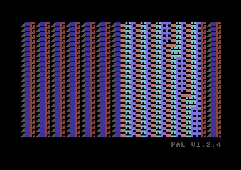

- Psychedelic rave color patterns

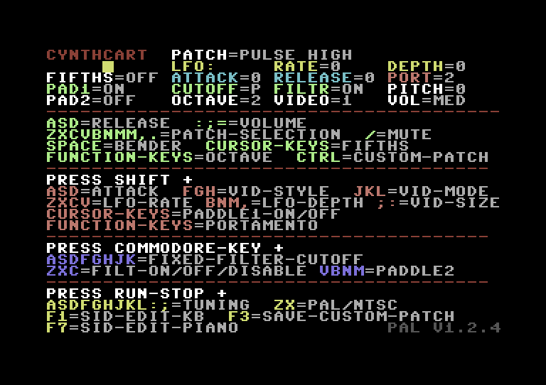

- On-screen help

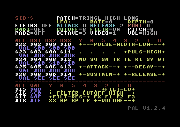

- SID hex editor for advanced users
- Can turn off video chip to reduce noise
- PAL and NTSC tuning tables with automatic selection
- Designed to be used easily without a TV/monitor
- Copies itself to RAM (cartridge can be removed after loading)

- Added dummy SID register to edit 3 oscillators at once

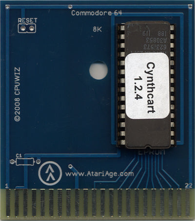

Configuration Options:

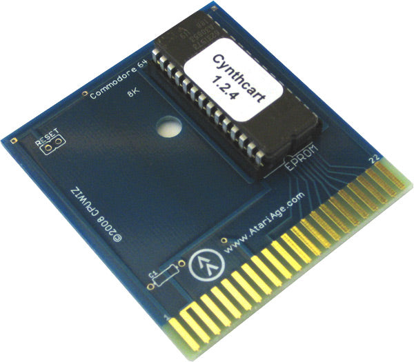

The Cynthcart is available in TWO different configurations:
- Board with the EPROM installed in a socket
- Board with the EPROM soldered directly to the board (no socket)
Without a socket, you can put your Cynthcart into a standard Commodore 64 cartridge shell (the ones made by Commodore). With a socket installed on the Cynthcart, the board will NOT fit in a standard Commodore 64 cartridge without first cutting a hole in the top of the cartridge shell. If you opt for a board with a socket, your Cynthcart can easily be upgraded when new versions of the Cynthcart software are available. Please be sure to select above which configuration you wish to purchase.

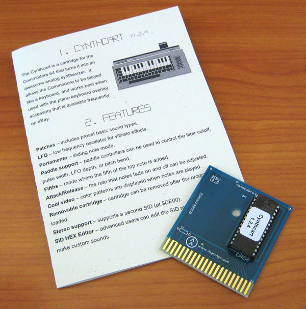

The Cynthcart also includes a manual written by Paul Slocum. Be sure to check out Paul's Synthcart for the Atari 2600 while you're here!
